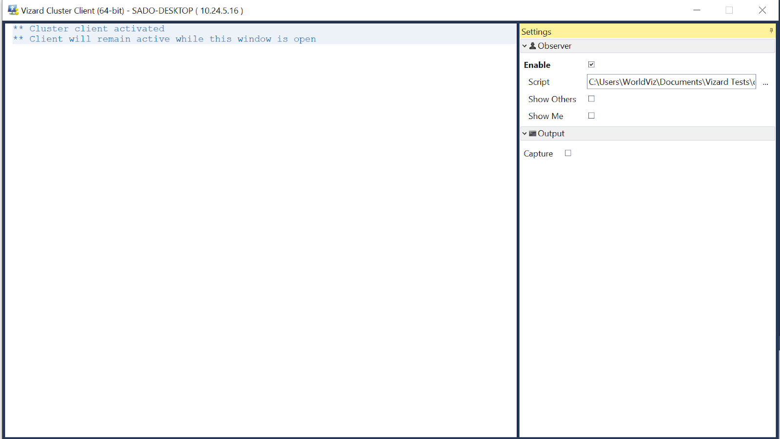

14. On the computer running as master start up tools-cluster master
15. On the computer running as client start up tools-cluster client
16. If not already checked check “enable” on the client’s side under observer and then where it says “script” point to the vizconnect file that you will be using as the client.
17. On the master side uncheck “show others” and “show me”
18. Make sure either “sync resources” is checked, or that you already have all of the resources in the exact same file path on the client machine (this works best if putting the folder directly on the C drive and have the C drive be named the same on both machines, otherwise, you can just sync the resources).
